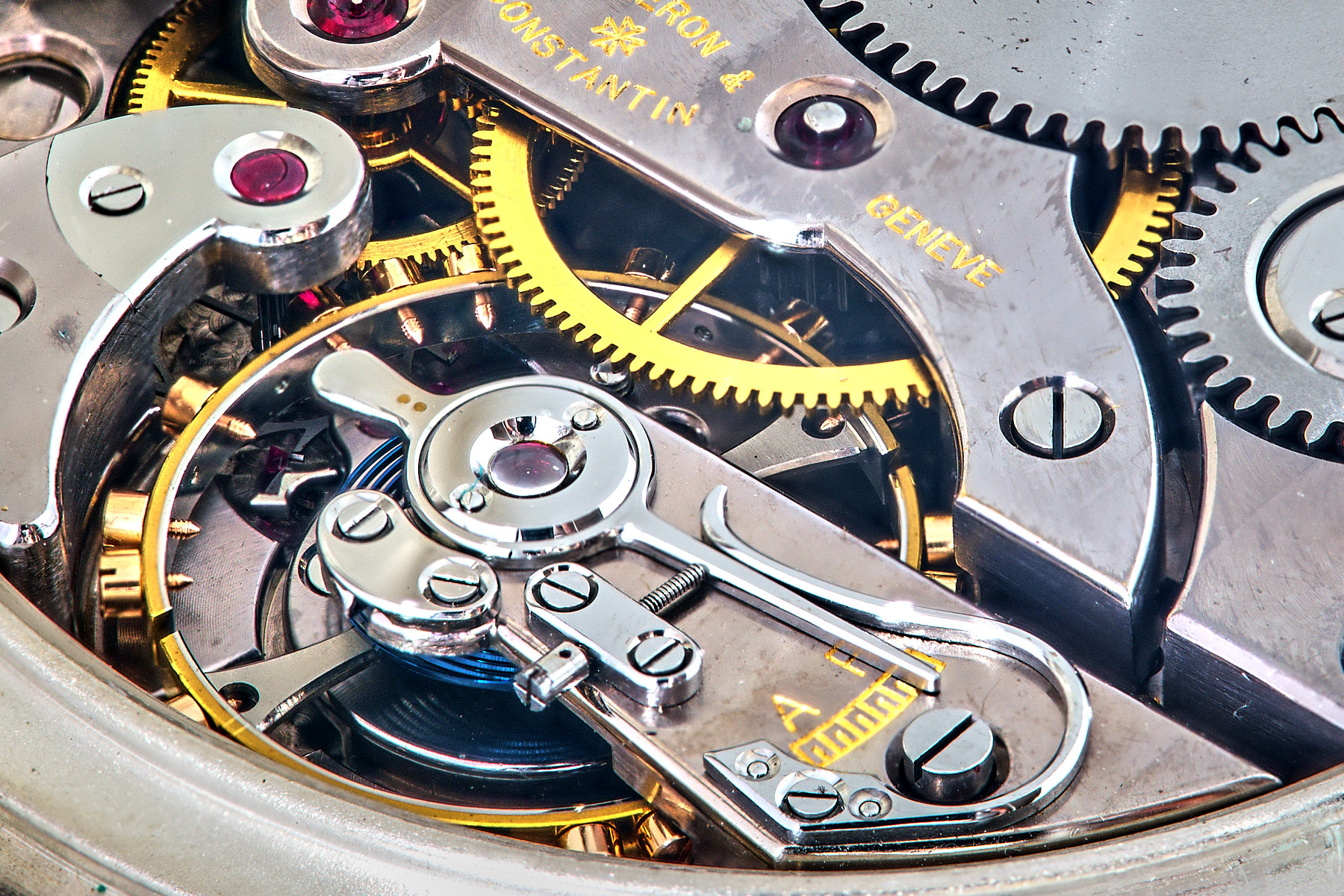

    2 Aug 2020, 11:12 a.m. 2 Aug 2020, 11:12 a.m.
    Thanks for the incredible photos Hebe
    - Cromagnonman

    Francis
    Connoisseur 195 posts
    4 Aug 2020, 11:06 p.m. 4 Aug 2020, 11:06 p.m.
    Lovely pictures and lighting!
    What caliber is that? My pocket watch looks to have the same caliber, except
    the fine adjustment balance lever(?) is different on facing the other way. I
    think mine is a c95.
    HEBE and Regnimelf3717 like this.

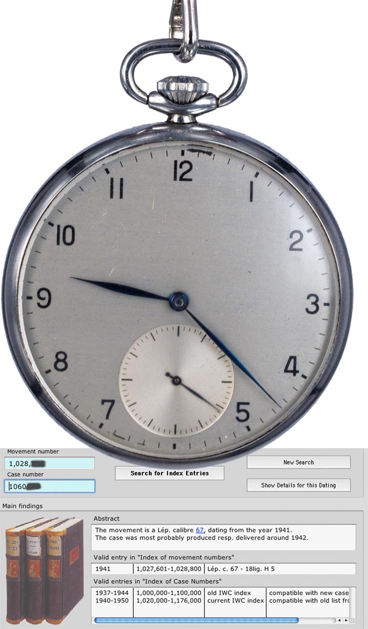

    Mr. Ralph Ehrismann
    Master 1423 posts
    20 Aug 2020, 11:38 p.m. 20 Aug 2020, 11:38 p.m.
    Good work, nice piece. Only few of the c.67 have the goose neck spring for the
    setting.
    It was the wok horse ("heavy" movement H5) of IWC, when the c.52 was stopped.
    I assume the balance was taken out of an c.52 H5.
    Kind regards
    watch77
    Regnimelf3717 likes this.

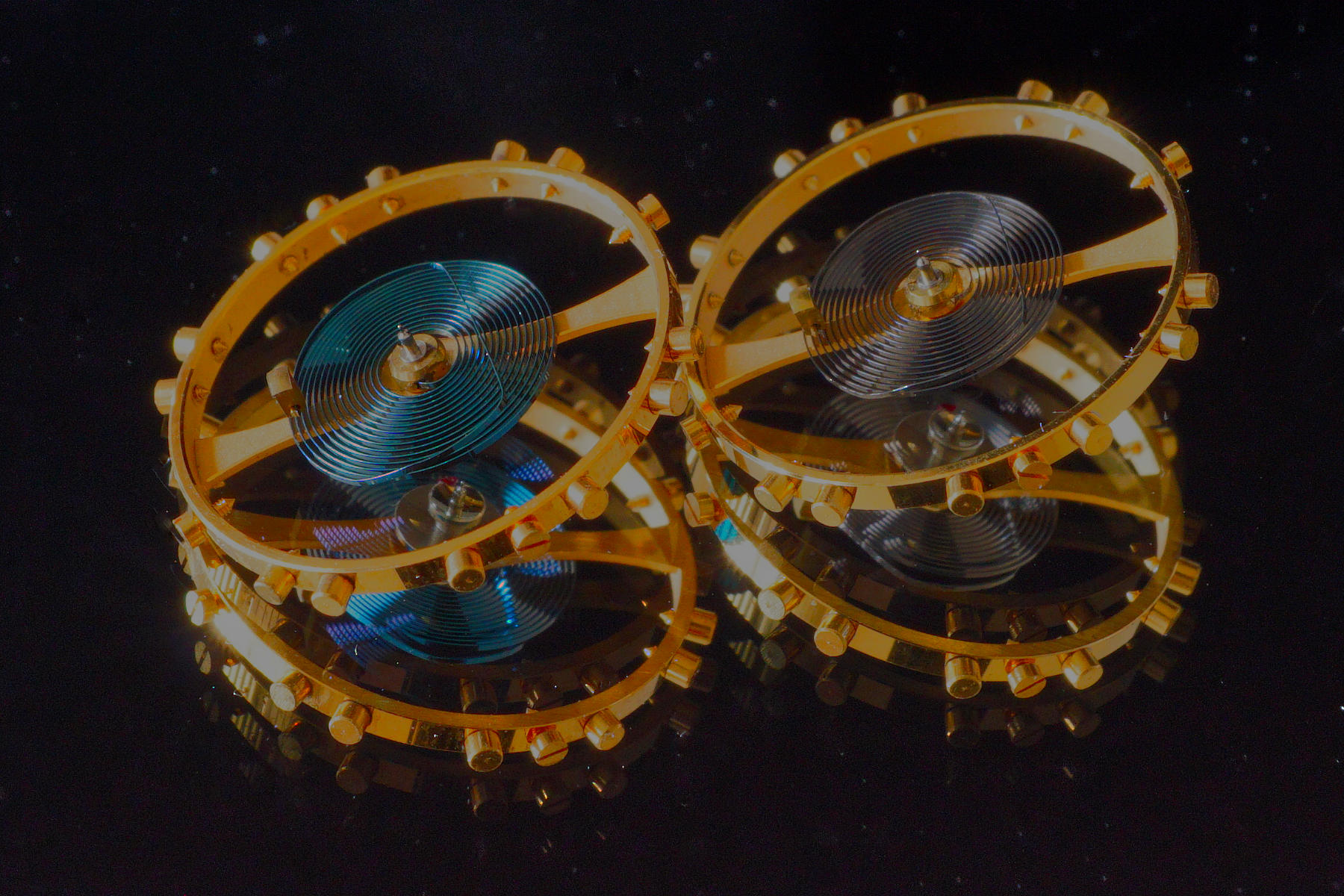

    21 Aug 2020, 9:15 a.m. 21 Aug 2020, 9:15 a.m.
    Interesting aspect Ralph.
    Many refs. of that era have very similar or identical balances.
    The "Fournitures" Book shows a cal. 67 with a bimetal balance.
    But another NOS cal. 67 from 1942 has a Glucydur balance. So, both types of
    balances have been used.
    An another bimetal balance from that era. JLC base movement used by VC.
    Heiko
    Mr. Ralph Ehrismann
    Master 1423 posts
    23 Aug 2020, 10:30 p.m. 23 Aug 2020, 10:30 p.m.
    Hard to belive the balance is original...,
    I never saw an original balance with added copper rings under the screws...
    But you are rhgt, I have never remarked it, in the furniture catalog most of
    the pocket watch movements are shown with com. balance.
    But the balance looks differernt in one of my movements
    regards
    Ralph

    31 Aug 2020, 8:31 a.m. 31 Aug 2020, 8:31 a.m.
    Thanks for the hint about the strange balance Ralph,
    and for the effort as well.
    I have two C.67 glucydur balances in stock, but the bimetal balance works
    fine. So, no need to change it.
    And a decorated C.67 BUND with goose neck adjustment.
    Heiko

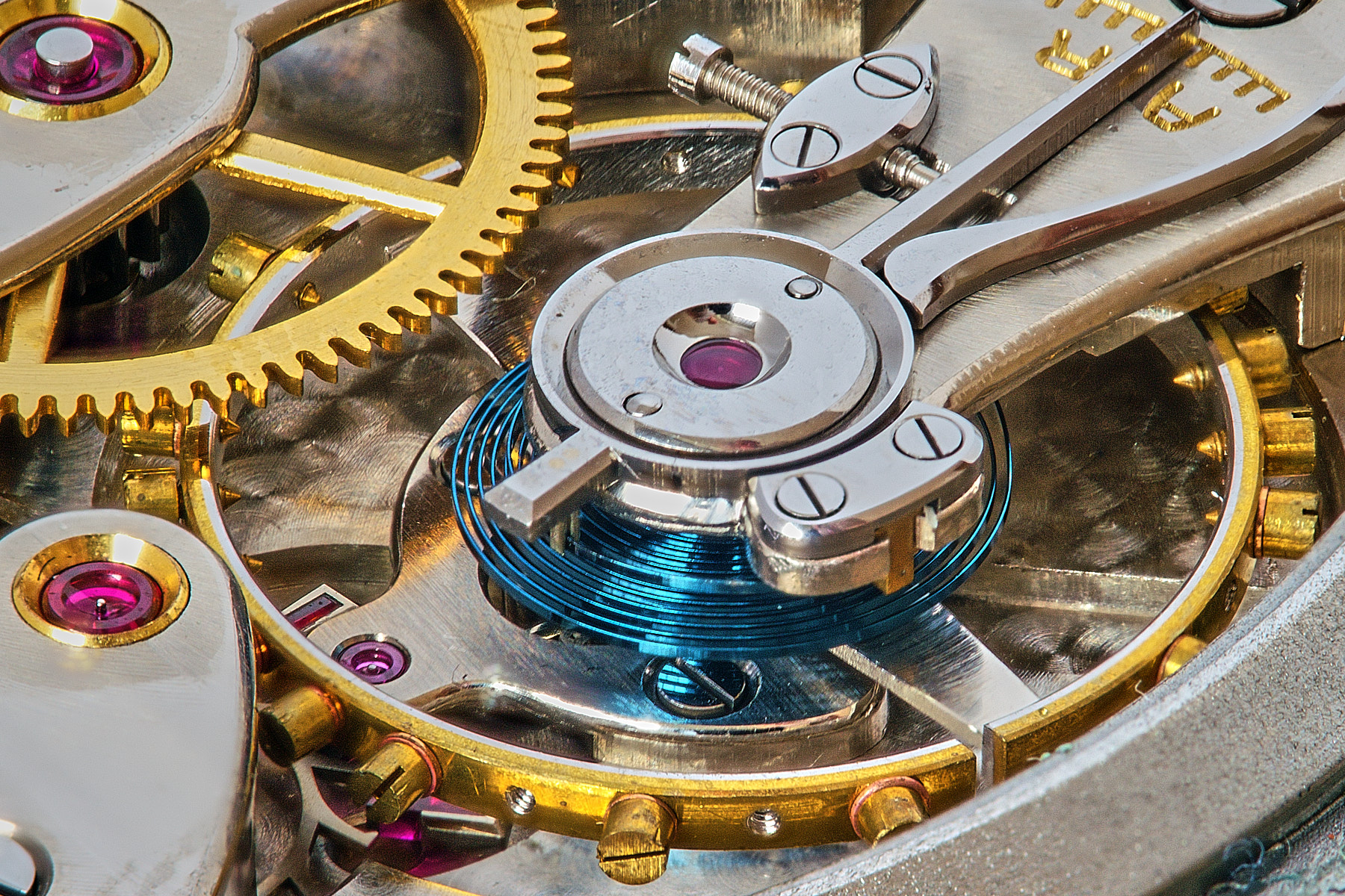

    Cromagnonman
    Insider 410 posts
    31 Aug 2020, 10:56 a.m. 31 Aug 2020, 10:56 a.m.
    Hi hebe et al,
    really interesting that there are copper or even better gold washers under the
    balance poising screws. It would be very interesting to know if that was done
    by the factory. The addition of the washers increases the balance inertia.
    However that is a lot of manual work done by the watchmakers. if we look at
    the photos from others, there are no washers under the balance screws. Of
    course the quality of your pictures are way better and it is easy to pot those
    details.
    You are not only a wizzard in tuning 3303 bracelets, you are a genius in
    taking macro photographs.
    thanks for contributing this most interesting shots.

    2 Sep 2020, 8:12 a.m. 2 Sep 2020, 8:12 a.m.
    Thank you Cromagnonman.
    I have this watch about 12 years in collection and I spotted an older photo,
    it shows another uncommon detail.
    The former dial was without any script and I kept it. I will compare it to
    similar IWC dials, because two uncommon details are strange ?!
