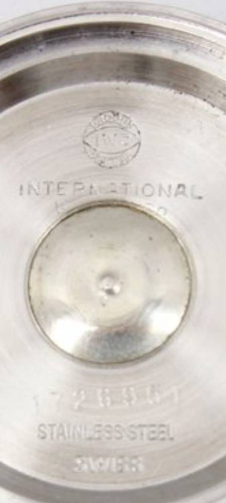

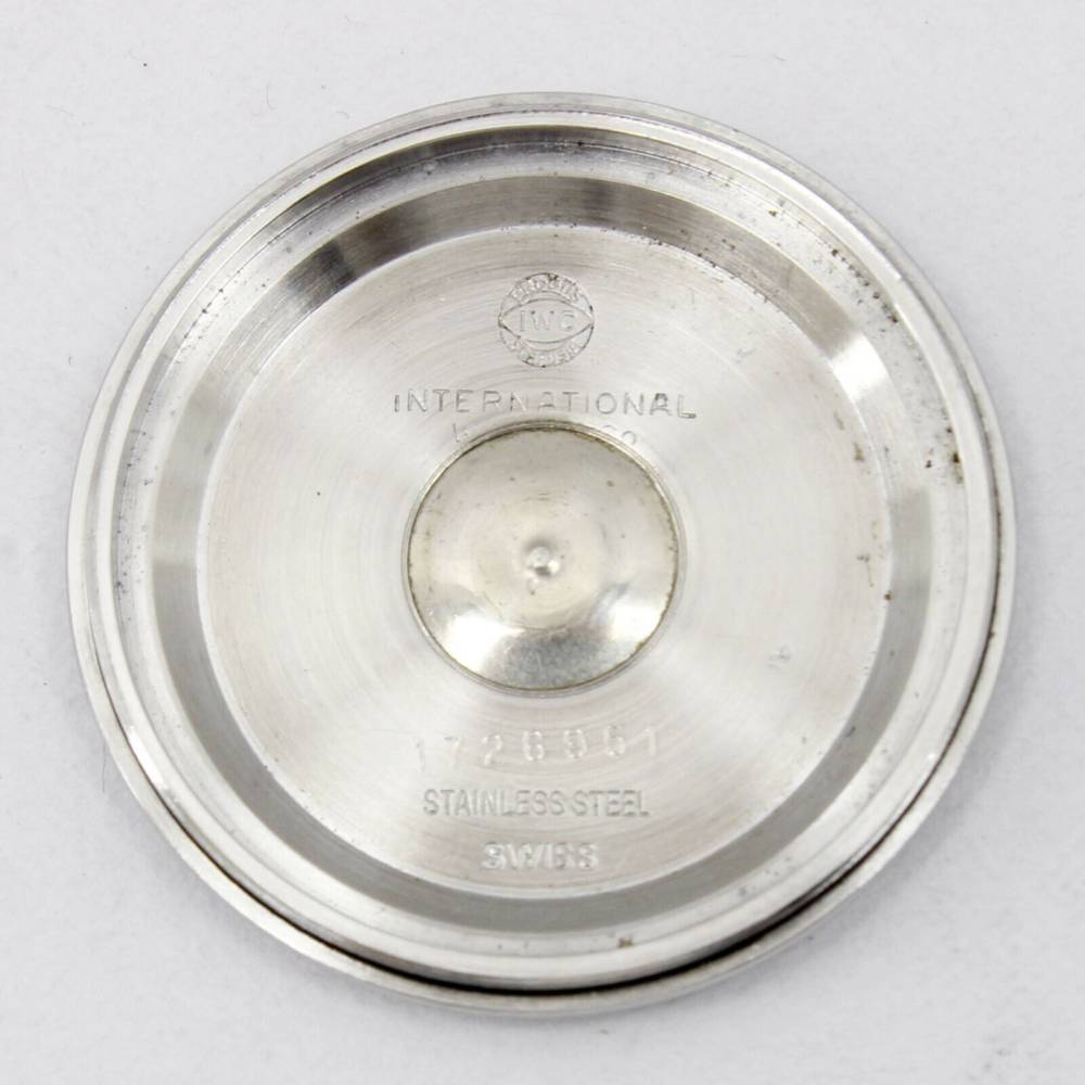

1. Have any civilian watches with the charcateristic 7-didgit number stamped
inside the case back been identified as having been produced in other years,
other than 1973 and 1983?

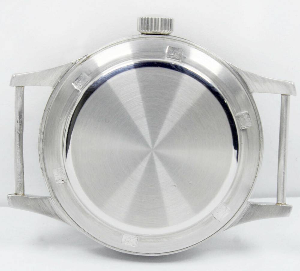

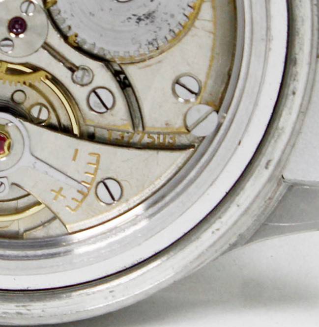

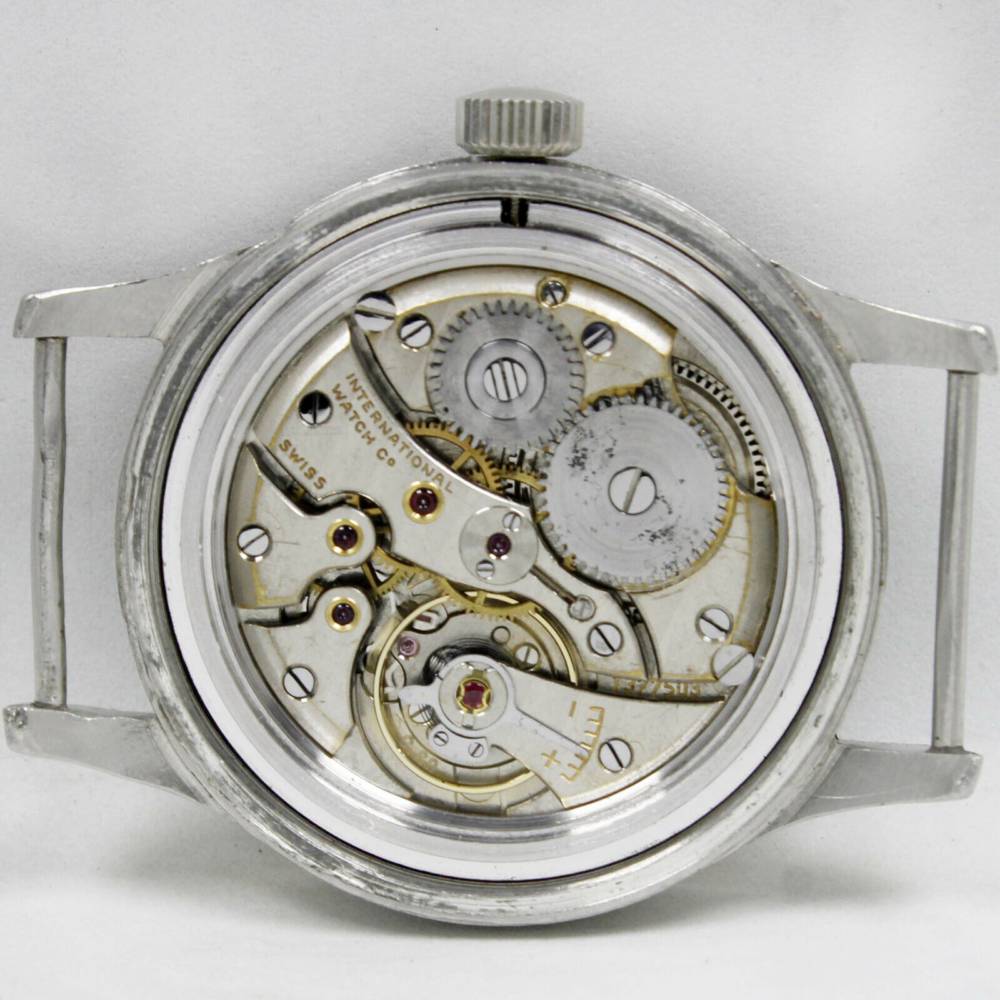

2. Have any civilian Mark XI been noted that have have movement numbers from
earlier production and case numbers from later production? In military issued
watches I understand that this is possible because MOD watchmakers were not
always meticulous about re-attaching case backs to their original cases after
they performed maintenance on the wtaches.
For dating cases and movements I used
www.moeb.ch/dyIWC/DYIWCh5/DateYourIWConline.html
