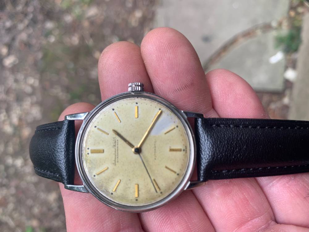

    I'm in the process of trying to clean the dial on this vintage piece, i would
    just like to know am i going about it the right way and is there a better
    application for removing these stains... you can see my start using cotton
    buds and water but its taking for ever and i dont want to remove the makers
    marks so any advice
    welcome

    Hi Gary,
    i am no sure if that is a good idea. The dial is made of several layers, the
    base metal, the galvanic coating and a laquer to protect the galvanic coating.
    Over the years exposed ro sunlight, humidity and ageing, the laqer get
    tarnished and starts to get stained. Processing the surface of old dials the
    way you describe, removes the laquer and exposes the galvanized surface. Over
    time the galvanization will start to oxidize and the result will look worse
    than before. The imprints on the dial will also suffer from this kind of
    "abrasive" technique.
    You can try, the worst thing to happen is that you have to give the dial for a
    reprint or a redail.

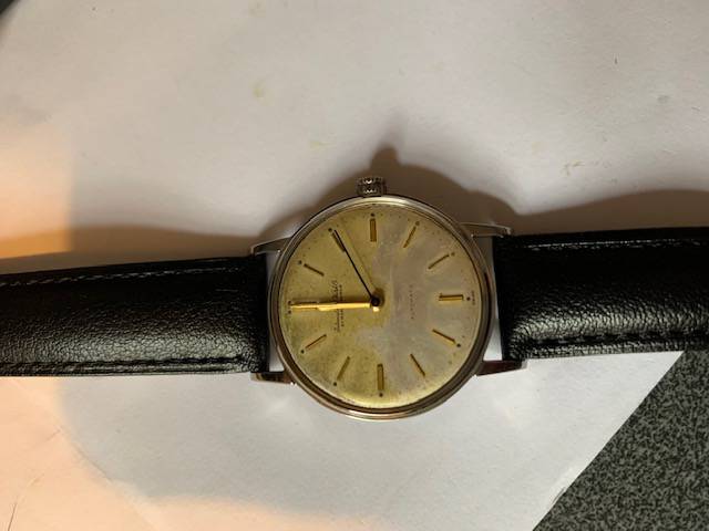

    Well im miving on just using
    water

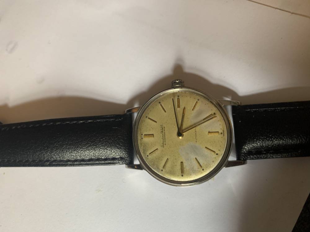

    Its very very slow work heres an
    update

    If im not happy with the end result, where could i get this basic 30mm dial
    from and what work is involved to replace it?
