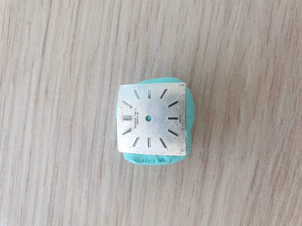

    I am starting a new hobby doing restoration of vintage watches. One of the
    first ones is a vintage iwc from 60s. When i was trying to clean the dial with
    distilled water the color went of. Went to iwc to ask if they can somehow
    support but they told me that they can offer only full restoration including
    the service and thats something i am not interested. Do you have any
    suggestion how to reprint the dial?
    thaks for your ideas

    there are companies specialized in reprinting - redonig the dials. This comes
    with quite some effort. Your dial has appied indexes that have to be removed.
    afterwards the dial has to be cleaned and sanded. Afterwards the brushing,
    galvanic coating, reprinting and application of a coating laquer is done.
    Lastly the applied indexes have to be reriveted to the dial. All the steps
    take time and will result in a certain cost.

    Thanks a lot for your reply. Do you know any company that specialized in it? I
    was searching on internet and tried to reach some but most of them didnt even
    reply back. If you have some experience feel free to share. I understand that
    to get it to great shape would be costly since it requires a lot of work. But
    since the value of the watch is not so high the estimated work cost must be
    reasonable. You are absolutely right that it is a big question if the vintage
    dials should be restored and has a thin line between. I guess its a personal
    choice. I personally would say that if there is a visible rust or stains that
    conflict the visual appearance its time to restore.

    i know at least two German companies in the dial restoration business.
    There is Bethge and Causemann
    If you type the Names in combination with "Zifferblatt" into your preferred
    search engine you should find them.
    br
