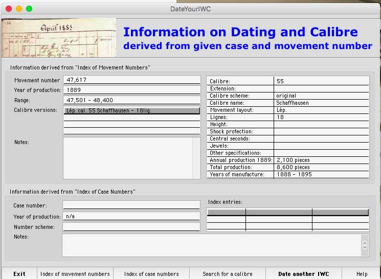

    This appears to be a frankenwatch. It has a PW lepine movement for sure. The
    small button by the crown is the pin set to allow time setting. The dial,
    crown etc are all fake. The watch has no value to a collector as a watch.
    30 Oct 2019, 7:51 p.m.
    Bill was missing one digit when he entered the movment number into the
    database. The movement No. 476170 is a LÈp. calibre 52, dating from the year
    1910.
    A good local watchmaker should be able to service this movement and get you
    runnning again.
