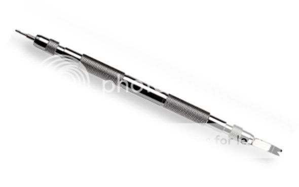

    You need a spring-bar tool to do the job. You use the split end to grip the shoulders to depress the springbars.
    [i1335.photobucket.com/albums/w680/regnimelf3717/IWC/A34F91C7-28F0-4F3F-AD37-0C9EAE89D75E_zpsyqqzfep2.jpg](s1335.photobucket.com/user/regnimelf3717/media/IWC/A34F91C7-28F0-4F3F-AD37-0C9EAE89D75E_zpsyqqzfep2.jpg.html)
