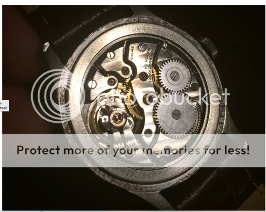

    There is a cal. 88 on eBay at the moment that I am interested in. It looks lovely - it is in very good cosmetic condition - but the only concern that I have is that there does not appear to be a serial number on the movement! I contacted the seller, and he says that he cannot see a number on the movement at all, but that the number on the case is 1164740, which dates it to 1949, according to DateYourIWC.
    This is the movement -
    i598.photobucket.com/albums/tt68/davies_01/e28f33c2-21f8-4a36-9882-b3a4501c069c_zpsjdczuwwd.png
    i598.photobucket.com/albums/tt68/davies_01/8b357c02-b79e-473b-b86f-9b168b49a1a4_zpspl0lswys.png

    My question is mainly this - could this possibly be a genuine cal. 88, or is it another Frankenwatch, like my other thread?

    I believe this is an OK cal 88. The cal number should be on the base plate, on the right of the balance cock.( looked at the position of the first picture )
    30 Mar 2016, 10:02 p.m.
    There is a serial number on the movement, you can see parts of it (but not read it)
    It is between the balance cock and the barrel bridge.

    Thank you very much for your help, Tonny and Watch77! Yes, I can see what you mean about a serial number in the right place for this movement, just partially visible owing to the angle of the photographs.
