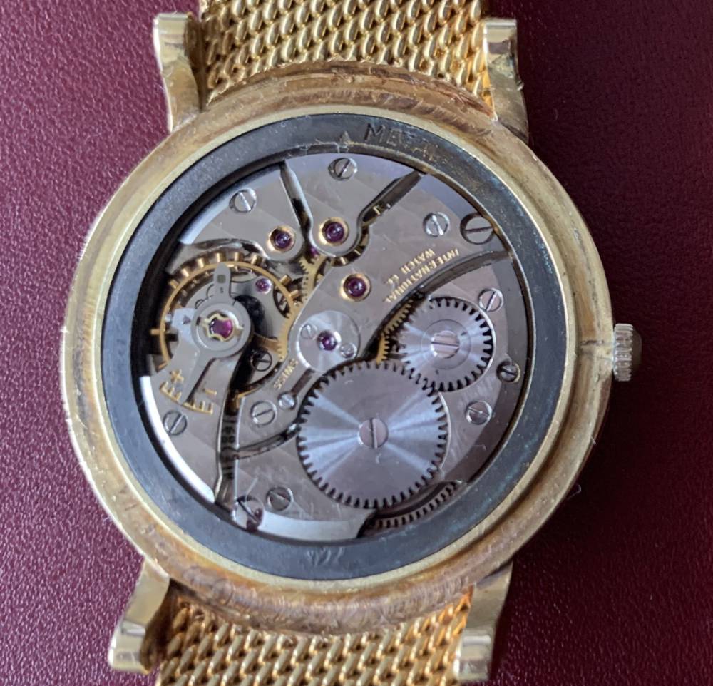

    Hello,
    Serial number is lower than 1,288,600 and database says: "The first series ist
    marked as calibre 40., (...)having no fine adjustment"
    But as I can see, there is a fine regulation with +/-?
    So my question: is it a Cal. 40 or 401? And are there further informations
    about the movement?
    this is a watch from 1952.
    Thank you for help!Iwc cal. 40 or

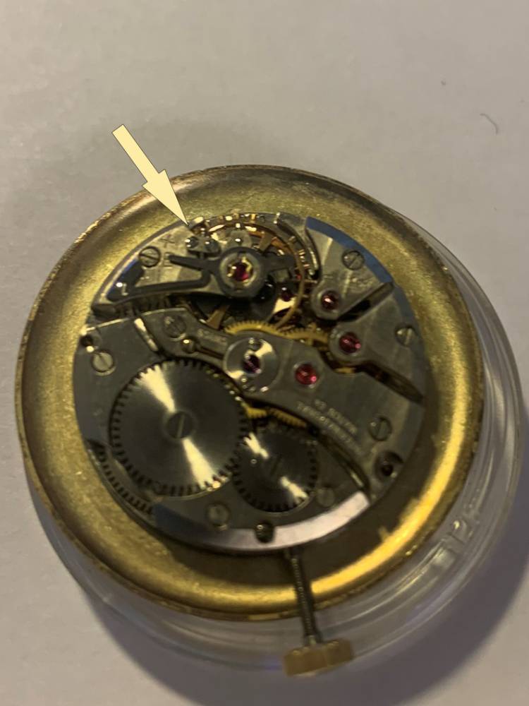

    Hi Kubus,
    below you find a picture of a CAL. 401 with a micrometric fine adjustment on
    the regulator index. I marked it with the yellow Arrow. This assembly is also
    called a "Swan Neck". This assembly allows very precise movement of the
    regulator Index. Your Movement is a Cal. 40.
    Sorry for the poor image quality
    br
