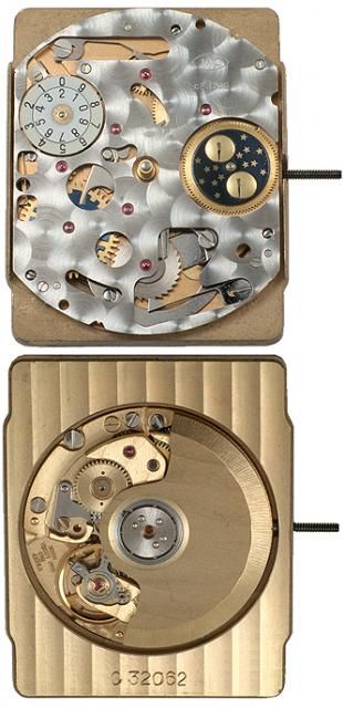

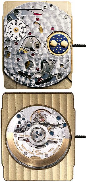

    Hi Richard,
    There are 2 possible movements for your watch:
    First image: Model 3545; years 1987-1995; Frederique Piguet based calibre 32061; 42 hour power reserve; clockwise only winding; 800 turns to fully wound.
    Second image: Model 354; years 1995-2001; Jaeger leCoultre based calibre 96061; 38 hour power reserve; both direction winding; 800 turns to fully wound.
    [i1152.photobucket.com/albums/p489/leosweeney/32062-1.jpg](s1152.photobucket.com/user/leosweeney/media/32062-1.jpg.html)
    [i1152.photobucket.com/albums/p489/leosweeney/96061.jpg](s1152.photobucket.com/user/leosweeney/media/96061.jpg.html)
    I have emailed you the instruction manual.

    Oops...
    Second image: Model 3546
