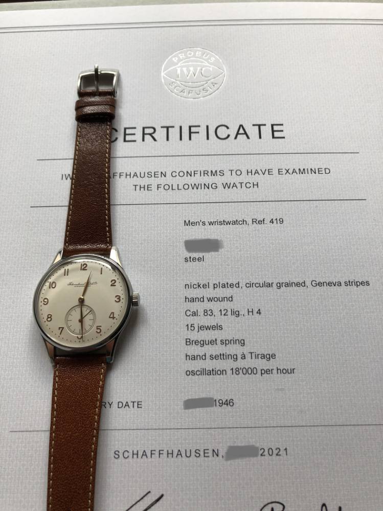

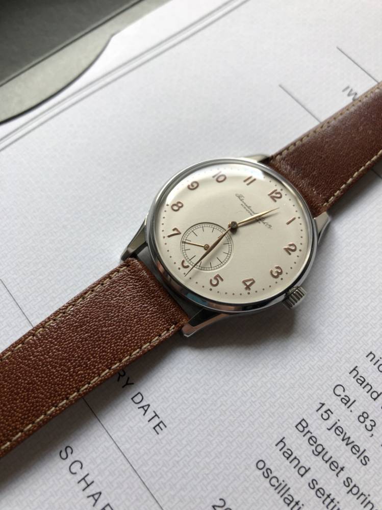

    I'm coming here to learn more about timepiece that I have and it seems to be
    really rare one.
    It's IWC Ref. 419 Cal 83 , steel mans vintage wrist watch from 1946.
    It is in perfect condition after IWC renovation.
    I do also have certificate of authenticity confirming the Ref and year.
    At first I was sure that this is Portugueser, but it's story seems to be more
    twisted.
    This watch is from 1946 and looks like Portugueser ref. 5441 form 1993.
    Could any of you who knows the story of ref. 419 enlight me a bit?

    Beautiful watch in fantastic condition!
    As the papers say...... It is a Cal 83 movement, which was a very popular
    watch in its time and was made from 1930 to 1947 at which time it was replaced
    by cal 88.
    There is a slight resemblance to Portugieser 325, but there is a big size
    difference and these came with pocket watch movements either cal 74 (1939 to
    1951) and 98 (1944 to 1970)

    Thank you Mark for you reply.
    I do realize that Cal 83 movement was commonly used at that time but I
    couldn't find anywhere any info about model itself, so Ref 419.
    It would be grate to figure out how many of them where produced and what is
    the historical value of this timepiece (if any)?
    Also I was trying to find any historical auctions where this model was sold to
    estimate the value and I couldn't find any.
    Indeed I'm pleased how well it was renovated by IWC. It looks like brand new!
    Thank you

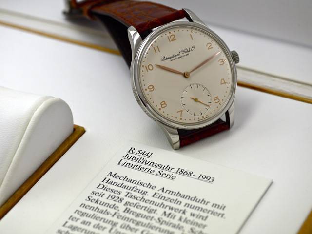

    Amazing is how similar is the dial of Jubilee Portugieser - Ref. 5441.
    Seems that designer run out of ideas :)
    All the best
    KNG
