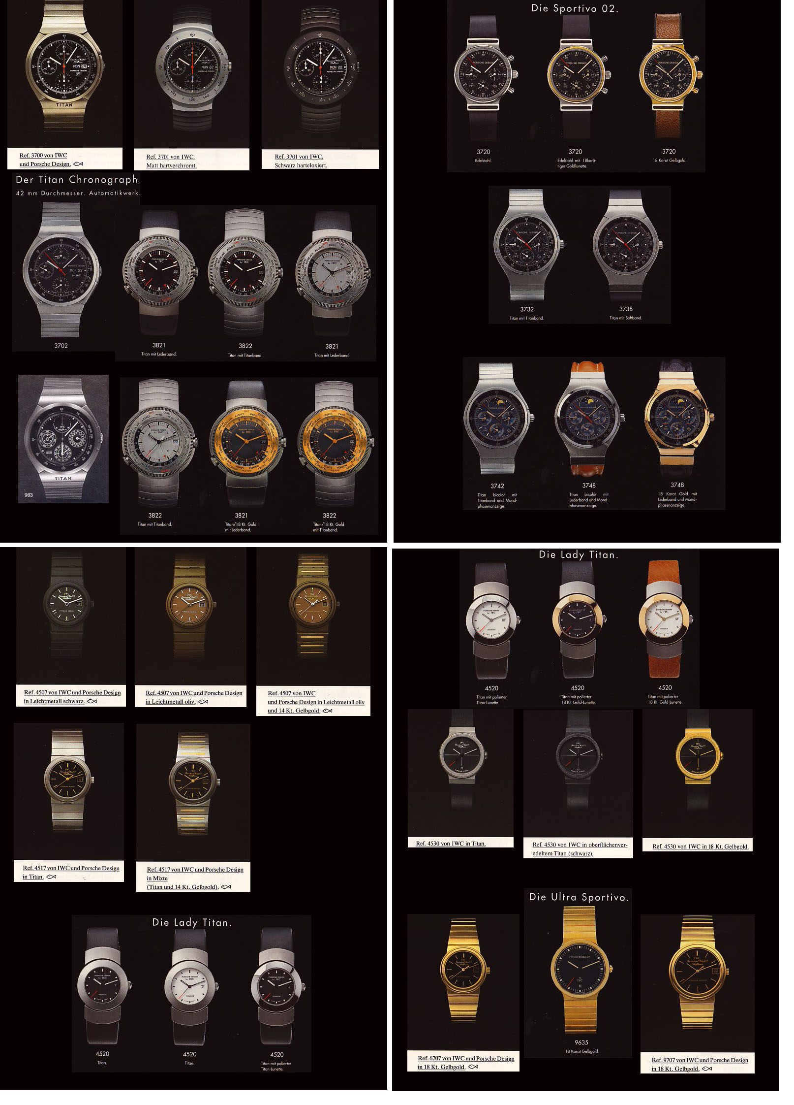

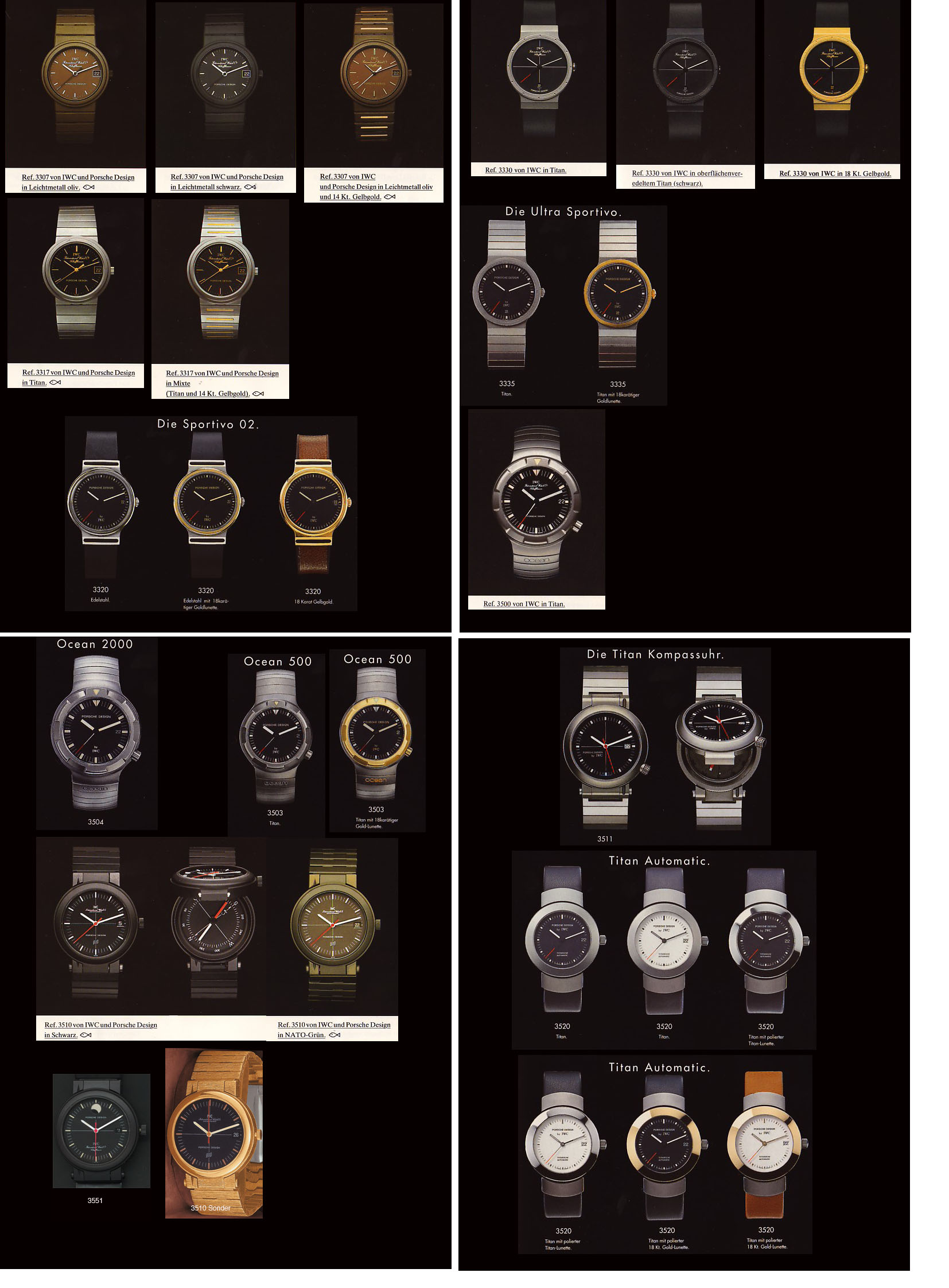

    10 Jul 2019, 3:41 p.m. 10 Jul 2019, 3:41 p.m.
    @ GIULIANO and @ NELSON: Thanks for your motivation about my photos.
    Just checked catalogs from the 80s and notices the ref. 3510 discription with
    a detail: NATO-Green.
    Most probably misunderstood and the basic for the MILITARY myst ?!
    And photos of a very rare 3517:
    fourormore likes this.

    10 Jul 2019, 3:48 p.m. 10 Jul 2019, 3:48 p.m.
    do you have a pic of the catalogue to share @HEBE?
    10 Jul 2019, 3:54 p.m. 10 Jul 2019, 3:54 p.m.
    Yeh, just found these older photos on my server:
