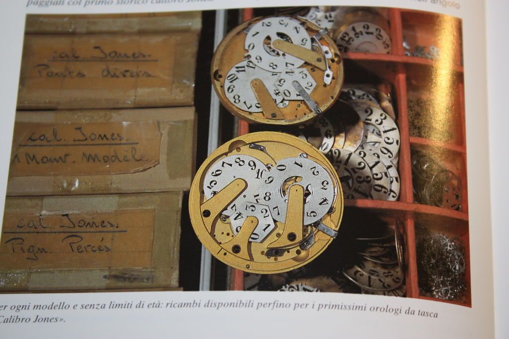

    A picture can clarify the problem:
    i1069.photobucket.com/albums/u473/costi92/IMG_0726.jpg
    The movement lower down in the picture is certainly a Pallweber II, but the upper one is always a Pallweber II? The movement n. 554 is entirely similar to the top one in which, however, the numbering on the hour disk and on the minute disk run clockwise and the 10minute disk is anti-clockwise.

    12 Apr 2012, 6:28 p.m.
    Dear Giovanni, Rolf and Hans-Georg,
    Thank you for keeping up the discussion.
    The both movements you can see on the pictures that posted Giovanni are from the IWC collection.Below you see the movement Pallweber II, H7 19''', Nr. 979; above Pallweber I, H7 19''', Nr. 350.
    To examine if Nr. 554 is a Pallweber I or II it would be very good to have a under dial view.

    12 Apr 2012, 11:11 p.m.
    Thanks David and Ralph for your opinions.
    The watch is now at my expert repairman because he has the straight support of ten minutes disk damaged and doesn't works well.
    For this now I am not able to provide an under dial view. I hope I can show you a picture in the coming days.
    I did not know that the two movements in the figure were from the IWC collection.
    Now two questions for David:
    1) The movement n. 350 is cased or not?
    2) Is it possible to have a view of the other side (the back side) of the two movements n. 350 e n. 979?
    Giovanni
  • Insider
    13 Apr 2012, 7:13 a.m.
    Dear David
    By which criteria do you judge the upper watch on the picture (number 350)
    to be a Pallweber I ?
    For me it is just an "ordinary" Pallweber II .
    Rolf
