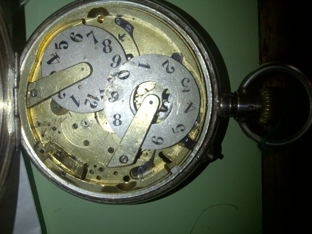

    23 Apr 2012, 8:31 p.m.
    Dear all,
    The mechanism of 554 allows to adjust only backwards, but I do not know if this is due to the problem of the bridge of ten minutes disk, that is not original, but was replaced by a welded bridge system.
    Finally here the photo, without this bridge and the ten minutes disk and still with a piece of metal welded on to which was grafted the bridge added to support the ten minutes disk:
    i1069.photobucket.com/albums/u473/costi92/IMG-20120423-00025.jpg
    The plate and the brigdes are certainly of Pallweber I, but the movement in the under dial view seems varied with respect to that of n. 331 and 350.
    There is, maybe, a Pallweber I bis?
    Giovanni
    24 Apr 2012, 11:25 p.m.
    Dear Giovanni,
    to be honest, I´m not quite sure what to say. According to the under dial photo it could be both Pallweber I or II. Interesting thing is the adjust only backwards you mentioned.
    If you maybe will visit Schaffhausen and the IWC Museum, please let me know. If you like we then ask a service watch maker to have a look on your Pallweber watch to clarify which Pallweber mechanism it is.

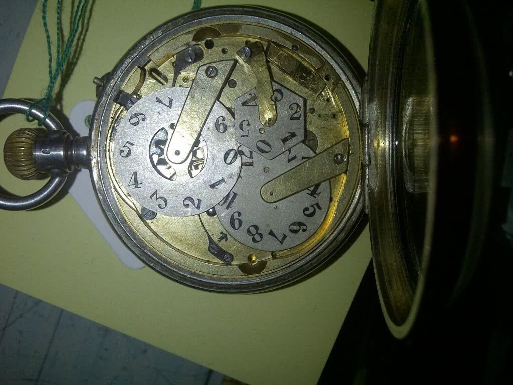

    25 Apr 2012, 2:02 a.m.
    Many thanks David,
    here an other under dial photo. This time the movement as it had been improperly repaired
    i1069.photobucket.com/albums/u473/costi92/IMG-20120423-00026.jpg
    Best wishes
    Giovanni
    25 Apr 2012, 6:28 p.m.
    Dear Giovanni.
    The interesting part lies unter the wheelwhich indicates the minutes 0-9.
    The pallweber I has there only a star just on top of the wheel with the missing dents, moving directly the wheel with the minutes 0-9.
    The Pallweber II, I think, has an intermediate wheel and a star moving the
    wheels with the minuts.
    But maybe there are different variants (prototypes)
