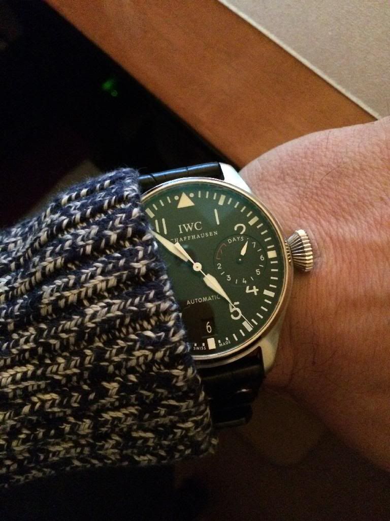

I have a problem with my Big Pilot
The power reserve indicator is still in 7 after many days.
The watch is working bur after 10-15 min stoped.
Any ideas?

No simple idea, other than it's time for a spa visit.
It's already in the spa ... :-)
Thanks o lot ....
Kollnik, is it 5004 or 5009?
Hello everybody. I also have a problem with my power reserve indicator on my IWC Big pilot. When it displays 5,5 days the watch stops in spite of the fact they have 7 day power reserve. Is that a problem or a permissible deviation?
It is a problem. Off to the watch Dr.
Its 5004 Emir...
