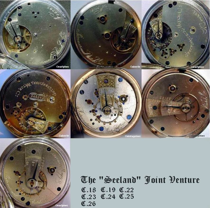

    The c.18 to c.26 (no c.20/21)
    Some years ago earlyiwc made a collection of pictures of the various Seeland movments.
    Later it was more clear, c.18 to 23 are no seeland's
    regards
    www.vintage-iwc.ch/bilder/7_seeland.jpg
    Various "Seeland" -movements

    Thanks very much, Michael and Ralph.
    The numbers of calibres 24-26 (Boston but really Seeland) range from 28,000 to about 38,800. The numbers of calibres 18-23 (Seeland, but perhaps later) should be higher than 40,000 and go up to about 60,000 but perhaps are not continuous.
    I think it's realistic to think that they are produced about 11,000 calibres 24-26 and then around 5000-6000 18-23 calibres. Is this assumption wrong?
    13 Apr 2010, 10:10 p.m.
    Boston and Seeland
    The real production number are not very clear for this period.
    I think the production numers are higher than you indicate. (At least factor 2)
    For the numbers < 40000 there are gaps. Yes
    But I think : NOT SEELAND.
    Today I think the production numers are mostly used just as commercial argument. For the collecor its important to find or at least to see but finally to love such a watch.
    Ralph
