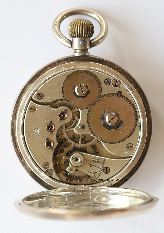

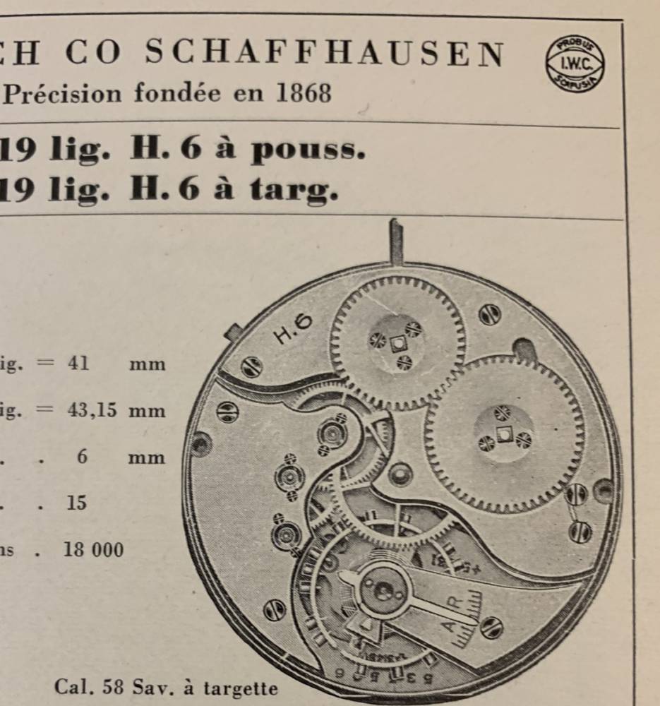

    Recently I stepped over a picture, making me some headaches.
    This is a click system wich is used in IWC pocket watches. Assuming it is a
    hunter type movement. Which caliber (or are there calibers) could be hidden
    behind this picture.
    good luck.
    Watch77
    22 Apr 2022, 1:58 a.m.
    I think some Cal 55 and Cal 56 came with the click hidden under the plate.

    HI Watch77

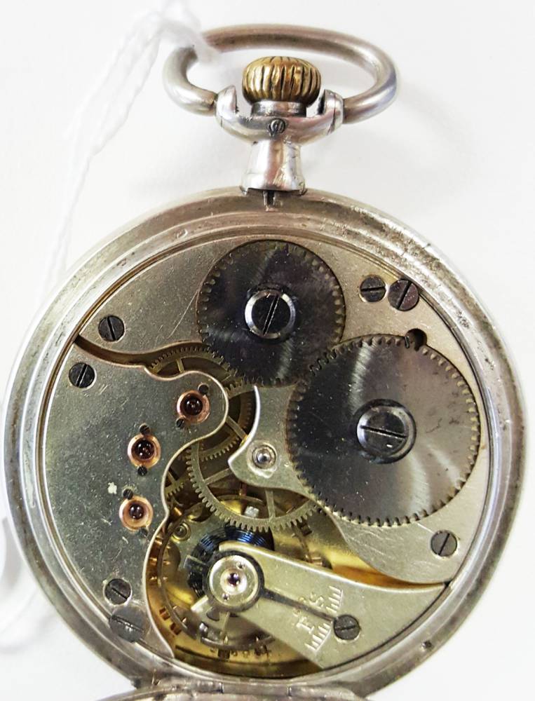

    Caliber 58 savonette i guess. I lloked it up in the Fourniturenliste but there
    of course the ratchet wheel is fixed with 3 screws instead of one.
    br

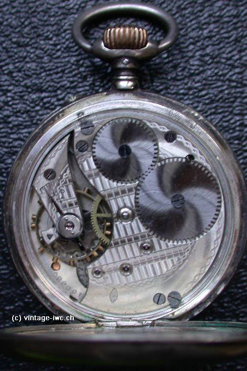

    Starting with the simples one. Lepine c.55 = Lepine c.Schaffhausen.
    It exists 3 main versions of this movement 1888, 1893 and 1894. Only the
    version 1894 has the has the requested "click system"
    Here a sample with special decoration probably for the US market: (c.55 18
    lig. Mod 1894)
    Then there is the savonette "pendant" of this c.55, the c.58 18 lig Mod.1894
    (initial caliber number)
    The next caliber having this click system is the Sav. c.56 / Lep. c.57
    pair also Mod 1894 (alse here the initial caliber numbering). I do not name
    this caliber family as "americaine" . This was only an specification of the
    caliber
    to the market for the first series (1889-1891), as there where some special
    features for the planned US-customer.
    The c.56 18 lig. Mod 1894 was not more an "americaine" but had the simple
    click system.

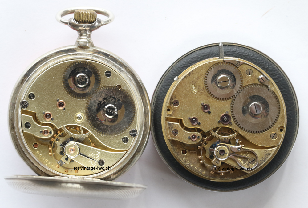

    Yes, there is such a movement. Behind the recognition of this movement type
    there is
    a strange story. Some years ago, when I was moving some of my watches from
    one stock tray type to a new one, I opened every watch to have a look at. That
    time I saw a short moment a c. 52/53 type watch with different click
    system, that oneof a c.57. Without thinking too much I kept in mind:"Aha,
    there is a cheaper c. 52/53 version too".
    Some years later, I wanted to examine that subject in depth.
    I opened all the caliber 52 I have in my collection (some more than 3), but I
    could not find that specific movement again and I gave up. Then, about a year
    later, I was scrolling not too motivated through auctions with "simple" IWC
    watches in the internet and: "Hmmm what is this! A c.53 with the searched
    click system!". A check with the Tolke list indicated: "Sav. c. 53. 19lig. H7
    Mod 1894"; nothing special. Finally I could buy the watch.

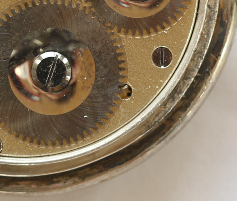

    One or two weeks later, I received the watch. I
    Nothing but the click system seemed to be special.
    But comparing the movement closer with an other c.53 19 lig Mod 1894 showed
    the
    difference.
    The movement is smaller and there is no space between the edge of the movement
    and the winding wheels for the normal click system...
    It has to be a caliber 53 18 lig. But nowhere in the tolke list there are 18
    lig c.53 for the between 1894 and 1904 except one serie 18/19 lig 276'601 -
    277'200.
    So it seems that some of the movements in certain series of the 19 lig series
    are 18 lig. (probably not only the found serie).
    An information of the IWC museum confirmed.... In the movements book on the
    first page of the 118'501-119'100 list, the 19"' is crossed out and corrected
    to 18"'. Maybe approx. 100 pieces of that serie where built as 18'''. (I have
    seen other 118'xxx c.53 with the normal click system).
    So now the call for your help. Could you check your c.53 19 lig Mod 1894
    movements/watches to find other series which got some 18 lig movements.
    Thanks Ralph

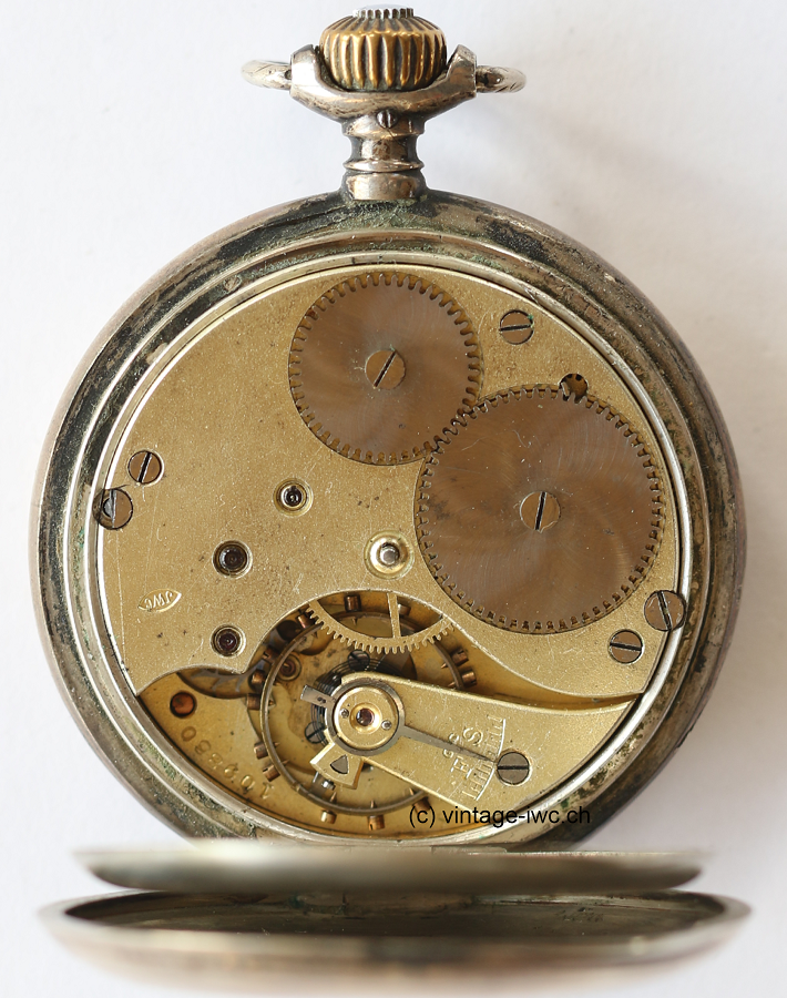

  • 25 Apr 2022, 9:09 p.m.

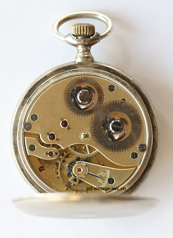

    Found this one in my collection with the same click system
    25 Apr 2022, 9:28 p.m.
    Dear Tonny
    Thank you for the picture, The c.56 (initial numberig resp) resp c.58 (newer
    numbering). I think a 19 lig. (I can't read the serial number).
    In the c.56/58 bith diameters (18 lig. and 19 lig) had the same click system.
    In the c.53 inly the 18 lig had. this (/easier/cheaper) system. I think there
    are less than 1000 pieces of the c.53 18 lig (really just an estimation, as
    you rarly see them)
    regards
    Ralph
