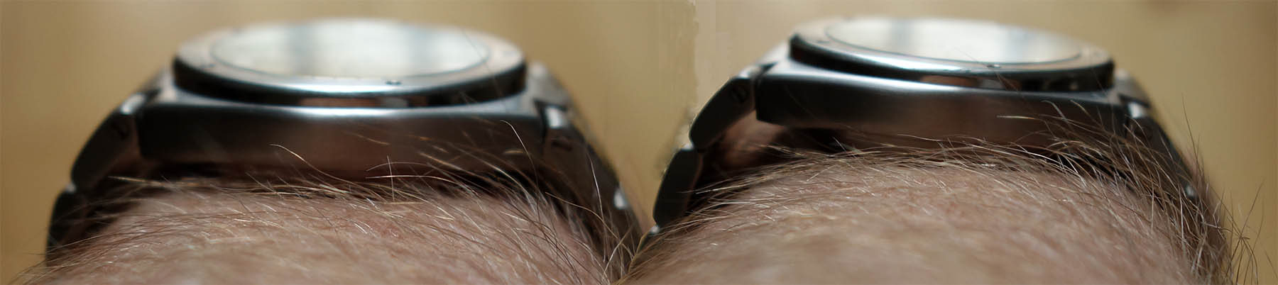

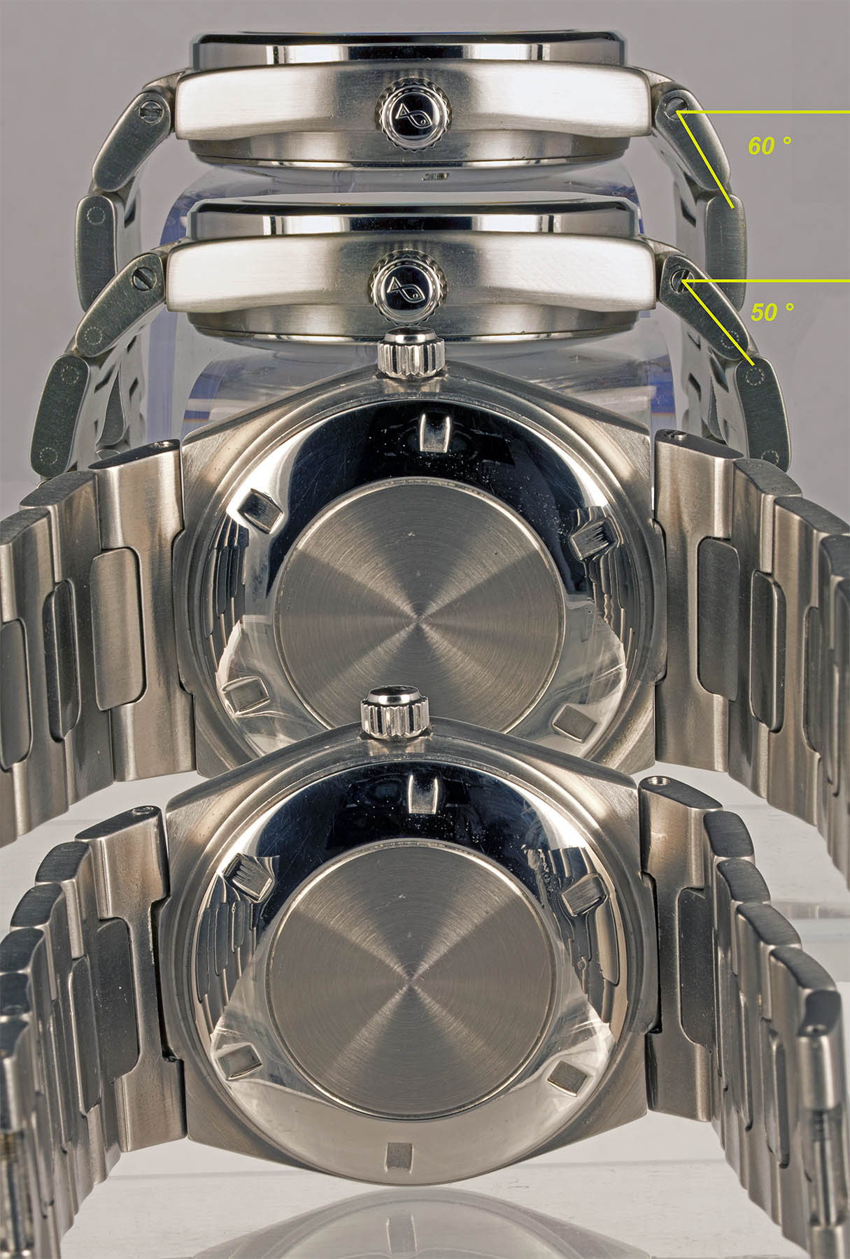

Now the project is finished except for the exchange of the crown. However, the
assembly of the steel belt was only possible with cutting deformation, see
photos. I finished the lugs with a file, because an angle of about 10 degrees
is required so that the lugs can move out of the rigid horizontal alignment.
Apparently the original bicolor bracelet was also reworked in a similar way.
Probably that was part of the mounting procedure at the time ?!
The use of the file worked perfectly and the steel bracelet fits now.
