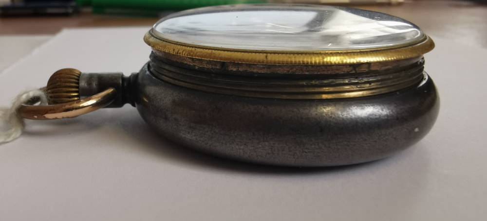

    As you can see on the pictures, to unlock the caliber, you have to pull out
    the crown to release the winding stem, then turn to unscrew.

    18 Apr 2020, 7:45 p.m.
    Borgel cases can be a mystery for a starting collector.
    When I bought one of my earliest IWC pocket watches I could not open it I did
    not realise it was a Borgel case
    Who would expect a screwed case 140 years ago? I tried to open it using the
    normal method : with a knive. I could see on the damage of the case rim that a
    previous owner did the same. Without success. The only thing which was
    abnormal to me on the watch, was the very thick case. Fritz Wagener asked me
    to translate a Borgel patent, which was written in French. Only then I
    understood what to do : pull the crown and unscrew the case. The watch
    survived.

    Here on can
    see, how thick the movement is to fit on the back lid.
