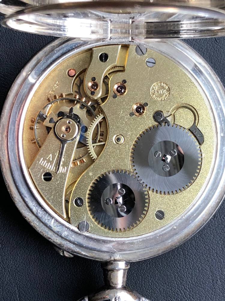

    This watch being older and from a period when the Cal. 67 still did not exhist
    (the first Cal. 67 left the manufactury in 1933) is fitted with a C.52.
    Fully restored and serviced, she runs just as the logo on the movement
    suggests - like clockwork : Probus Scafusia !
