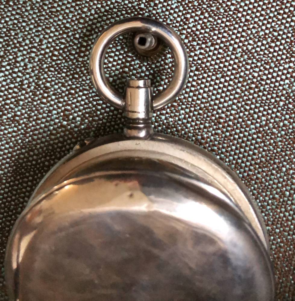

And if that was not bad enough.... just look what abuse she suffered when that
bow was removed (probably by the look of things in a brutal grab and stash hit
on the owner, where the watch was pulled off the poor owners chain, attached
to his waistcoat.)
and the other side of her neck, is even worse!
No ways is this then, a simple " lets just replace the bow ring " and we are
done project!

Now, she needs to be saved. But she has been drawn and quarted (judging by her
condition) and then hung by the neck. Can one save a broekn neck?
Answer: Yes we Can
And how is this done? Well lets start by taking another Pallweber in the
Collection and measure her up.
And to do it right, every single aspect needs to be measured.
And then it's off to the master case maker with the request to do the
impossible.
And there you have it folks, one cannot mend a broken heart - but broken
necks, well thats a whole different story. You judge for yourself, but I
believe our casemaker did a sterling job (including the forced patina on the
new neck) and that once completed no one will ever know that the poor fellow
had ever suffered a broken neck.
